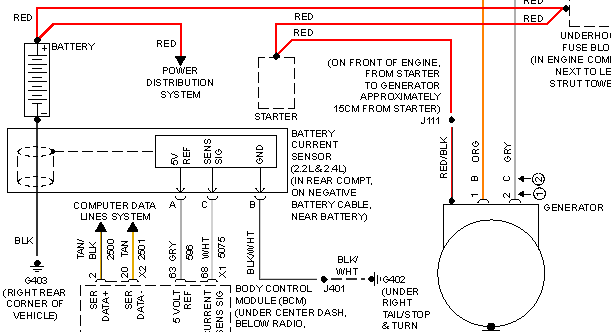

Originally Posted by donbrew
Not exactly FMG; the ECM sends a turn on signal and a duty cycle signal (which could be called an old fashioned regulator) to the Solid State Regulator (like a triac) inside the AC generator (that's what GM calls an alternator) which in turn turns the alternator on/off.
The wiring diagram is too big to attach.
I should add that the starter is actually part of the charging system, since the B+ goes there before it goes to the battery and the rest of the system.
Sorry Don. I put BCM instead of ECM.
I do understand how the alternator(generator) works. I was really just trying to let the OP know that the Autozone folks may simply blame the alternator if his car is not charging.
They're just parts sales people. Not technicians.

Can someone enlighten me on the possibility of a bad starter causing problems in the charging system since they aren't linked.
Went to look at voltage this morning and car off was 12.3 car on was 10.3 11.3 should be able to check more into those Saturday.
Old Jun 17, 2016 | 06:58 AM
Posts: 26,483
Not linked?
The + from the battery connect directly to the starter, the output of the alternator connects directly to the starter. A perfect place for a dead short, there are others.
Not linked?
Smh fat fingered it *are.
There are a few good places to short out.
Has there even been any reports of starters causing problems like this? I haven't seen any myself.
Also is there ways to bypass the starter to see if that's the problem?
Old Jun 17, 2016 | 04:44 PM
Posts: 26,483
We have seen a few problems like yours, but nobody ever reported back.
I guess the best way would check the alternator for a short.
