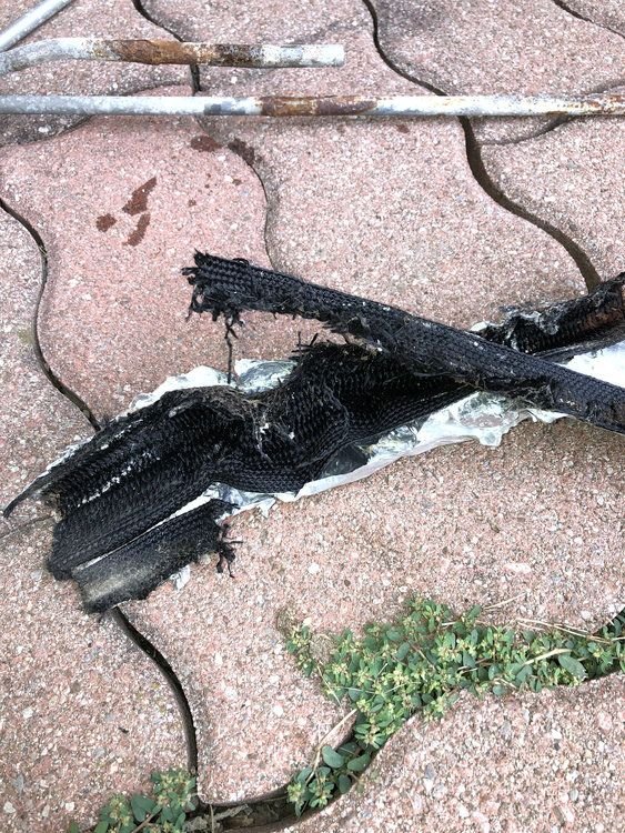

Well, I made a trip to Dallas this morning and here we go again. P0455 again! So far I have changed the evap vent and the evap valve. I think I am gonna pickup an ac Delco gas cap and give that a try next. My driveway is at a slope, whenever I fill up with gas I have to park it with the rear of the car the highest, if I park with front of car highest then I smell gas the next morning. Never see it on the ground or anywhere, but definitely smell the vapors. When car is half full it does not smell.

Crawl under and look up above and behind the rear axle beam, see the foil heat insulation, is it wet with fuel? Then replace the fuel and vapour lines.
This stuff absorbs most of the drips
Up there see the corrosion

Ah-HAH. NOW you mention the gas smell. Betcha when you get under there you'll find a rotten evap line.
