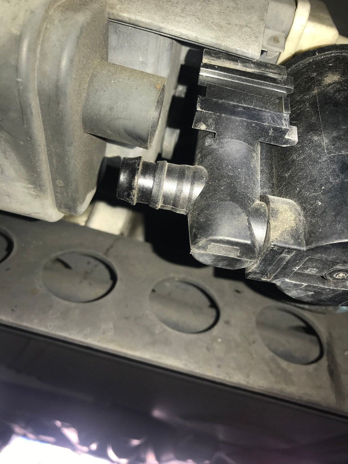

I gave up and took it to a mechanic.
They replaced the canister valve solenoid.
I had already replaced that. But, they found a seal was missing between the solenoid and the canister. They found an o-ring that fit and all is well.
I suspect that when I replaced the solenoid I left that seal on the old part, instead of moving it to the new solenoid. Thus fixing one issue and creating a new one.

Posts: 26,533
Very common. Some of the new boxes don't include the gasket and the old one is usually worn out.

guppy's Avatar
Joined: 10-19-2013
Posts: 419
From: Dallas Texas
So looks like the new one did not come with o-ring. This might be my problem.
