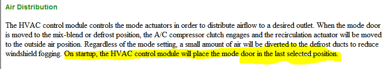

Old Jul 28, 2018 | 05:49 PM
So the click would be the actuator?
If I haven't changed the blend control why would it move at all? I can turn the car off and immediately restart and cause this noise... without making any changes to AC/heat/defrost controls.
Old Jul 28, 2018 | 05:54 PM
Posts: 26,533
It recalibrates itself. I think.

If this were the actuator then I should be able to make it happen by changing settings on the heater/AC controls. I'll check that tomorrow...
Old Jul 28, 2018 | 10:34 PM
Posts: 26,533
Why would you be able to make it go into calibration mode by changing settings? It calibrates at each non-zero voltage.
