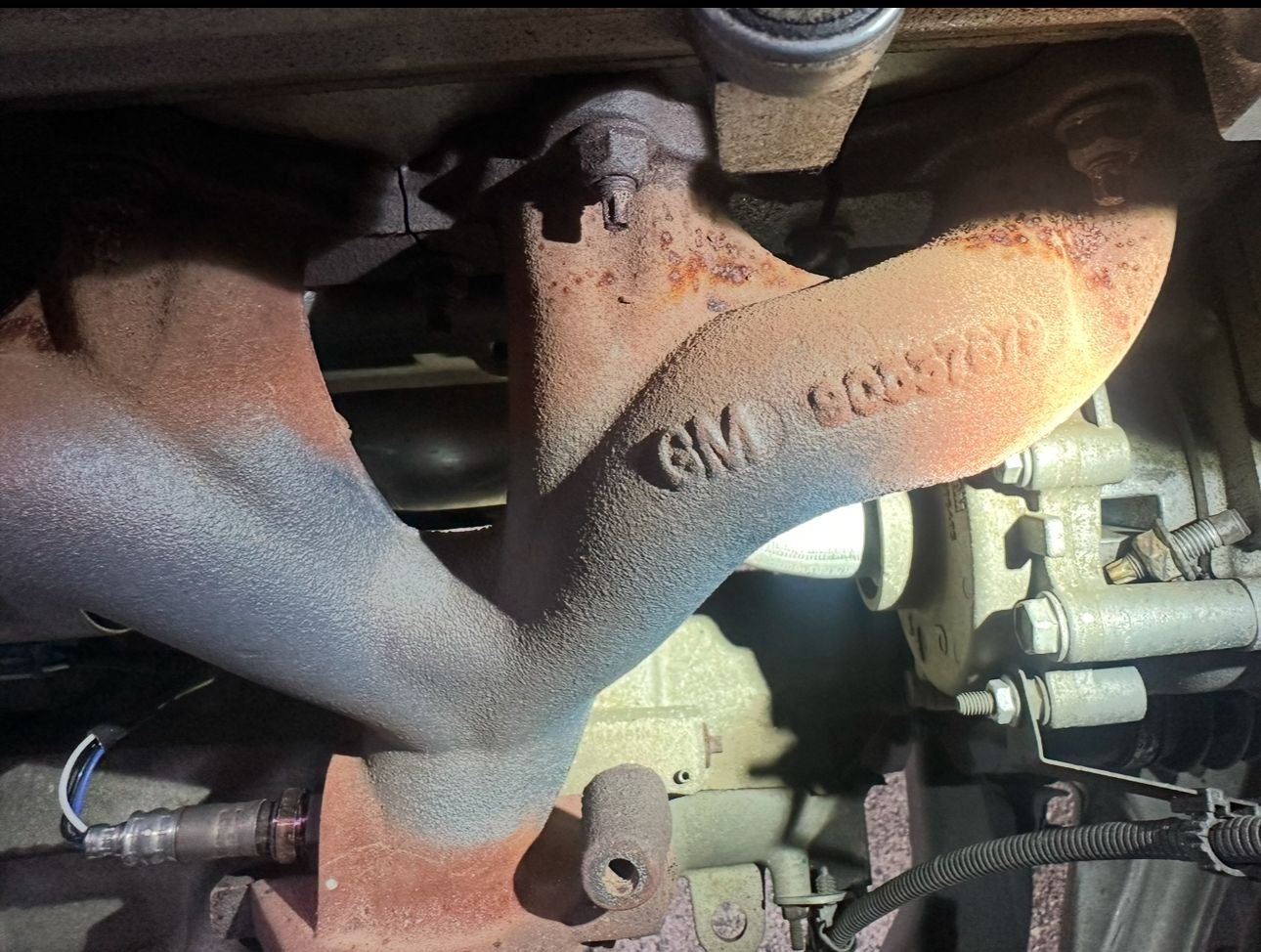

The leak would be before the upstream O2 sensor, so that could be the exhaust manifold gasket, loose fasteners, plausible.

It was hiding under the heat shield, see the yellow arrow
Here’s some pictures of the manifold and flex pipe that I took in July.

That was last July, loads of time , I suggest you inspect again, and the wiring harness for burnt connections, bent pins, corrosion
