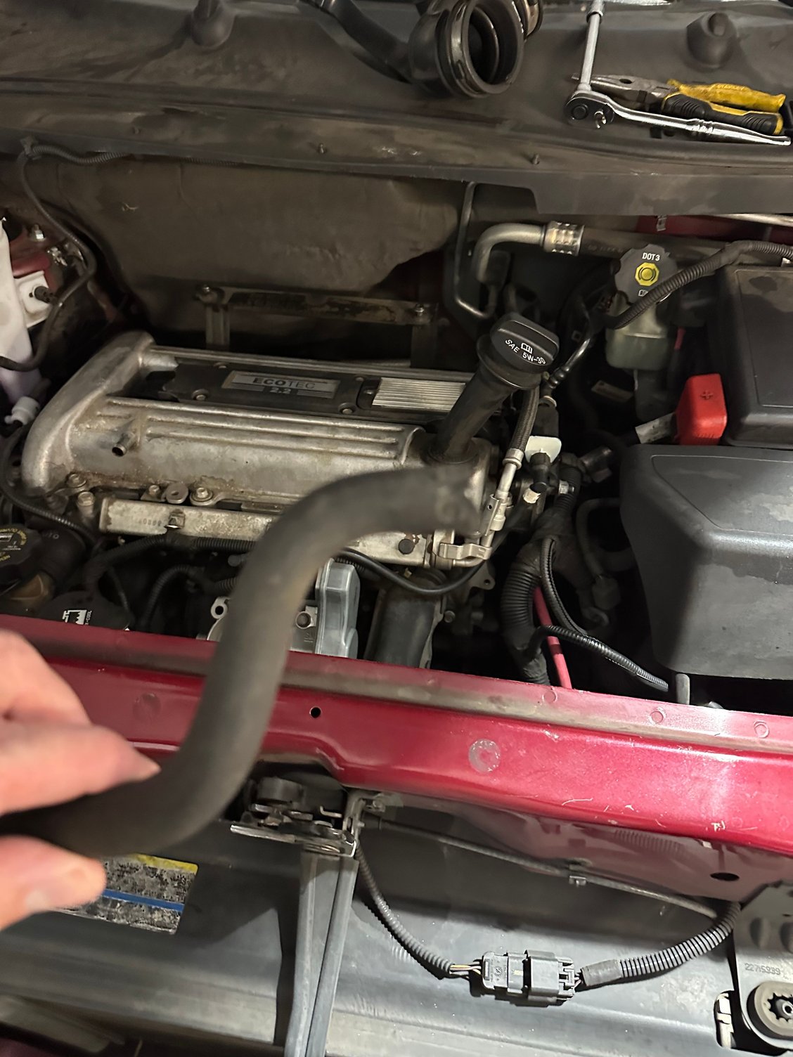

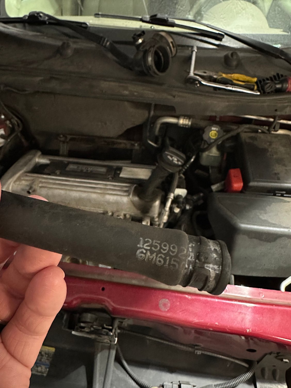

Got back under the hood this evening and when I took the engine cover off the PCV hose was broken off and probably cracked previously. I’m expecting this is the source of the Throttle Body codes. Not sure about the P0171 Lean code but hoping for some resolve there. Part is ordered and I will install when I get it.
Old Jan 27, 2025 | 08:33 PM
  #29
Posts: 26,536
Unmetered air.
