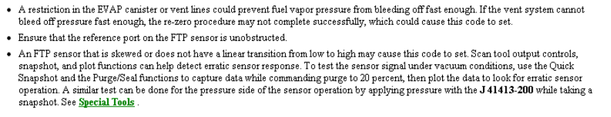

The P0451 is the problem. The fuel tank pressure sensor is not operating correctly.
It is probably holding the EVAP purge valve open causing the P0172, and I bet hard starting.
