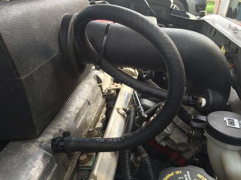

It's oil and engine condensation, I replaced the hose with a 3/8 fuel hose, looped up so the oil will run back into the valve cover.
