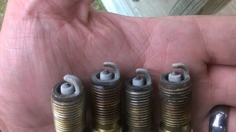

Well I havent had a change to do a compression test yet. I did take the time to pull the spark plugs today just to have a look.
Here is a picture of the plugs, they are in order left to right taken out of the engine.

They actually all look about the same, even though the picture makes the one on the left look worse.
Anyone have an opinion?

Looks like you need new plugs, the center electrode is gone, worn out. Those are probably original plugs. Not sure what the grey residue is. Is it ash-like deposits? Of course, it doesn't explain your coolant loss.
Old Sep 25, 2016 | 07:48 PM
Posts: 26,536
The one on the left might explain it; it looks steam cleaned from here.
Grey residue usually means lean, could be due to the horribly worn out plugs.
Those plugs have been bad for a long time.

Yes it is a gray, ashy textured deposit. Very hard and cooked on. I plan on replacing the plugs this evening and hopefully doing a compression test if the tool is available to rent. The plug on the left doesn't look much different in person, the picture just makes it look that way. I'm planning on getting Ac Delco 41-105 plugs is that right for an 06 with 2.2?
