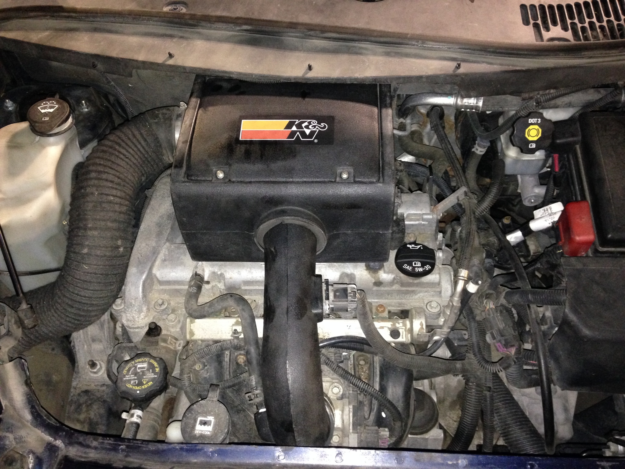

Because I couldn't see the coolant level clearly in the tank itself, I replaced the lower part of the small black hose with a piece of clear tubing. Now I can easily see the level by just looking down at that tubing.
Old Dec 9, 2016 | 06:52 PM
Posts: 40,068
George is that dirt? There on the rad support? A spot not waxed ? Or just my finger prints on my IPhone screen?
Great idea for the clear hose!

OMG - yeah, that does look like dirt. And the windings in the alternator has some caked on dust. I am aghast, shocked and dismayed!!!! (I will never show pics of my engine compartment............... never)
Old Dec 9, 2016 | 09:26 PM
Posts: 11,720
Probably a combination of dirt and mildew. Poor car stays parked a lot. That and living in a very humid part of the southern US can cause it to get "dirty" without leaving the garage.
Old Dec 10, 2016 | 08:44 AM
Posts: 40,068
Well alrighty then, up here it's road grime, salt, sand, beet juice and brine. I wash my engine bay at least once in May then again in October. Still I think you have the cleanest HHR SS out there!
