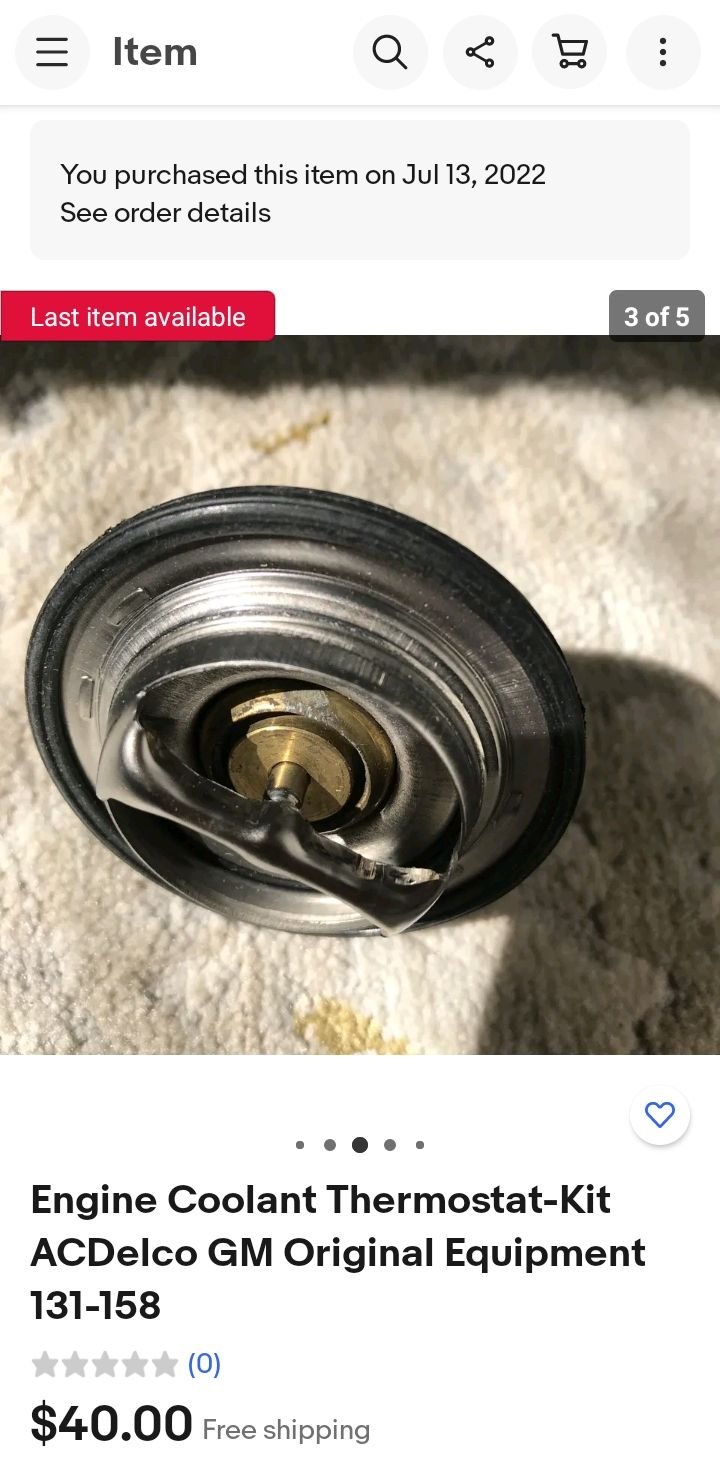

Question. I just bought a new AC Delco thermostat for my car (2007 HHR 2.2l) it did not come with an o-ring as I saw mentioned in other threads but there does appear to be a rubber seal around the thermostat itself. Do I need to get an o-ring or does that rubber seal take it's place? Is any other type of sealant needed? Thanks in advance for any help.

It has a rubber ring around it , no sealant required

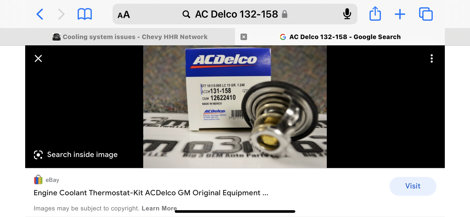

Did you get the 131-158 part number?
That is what it says on the package sir.

Old Jul 13, 2022 | 10:04 PM

If you pull on that rubber it will come off the stat. That is the O-ring.
Old Jul 14, 2022 | 07:37 AM
Posts: 26,484
We say O-ring for convenience. it is a rubber grommet that goes around the outside and seals the housing. The other t-stats have one on the valve part, it tends to fall partially off and blocks the valve open.

Which thermostat is this then?

You got the good one.
