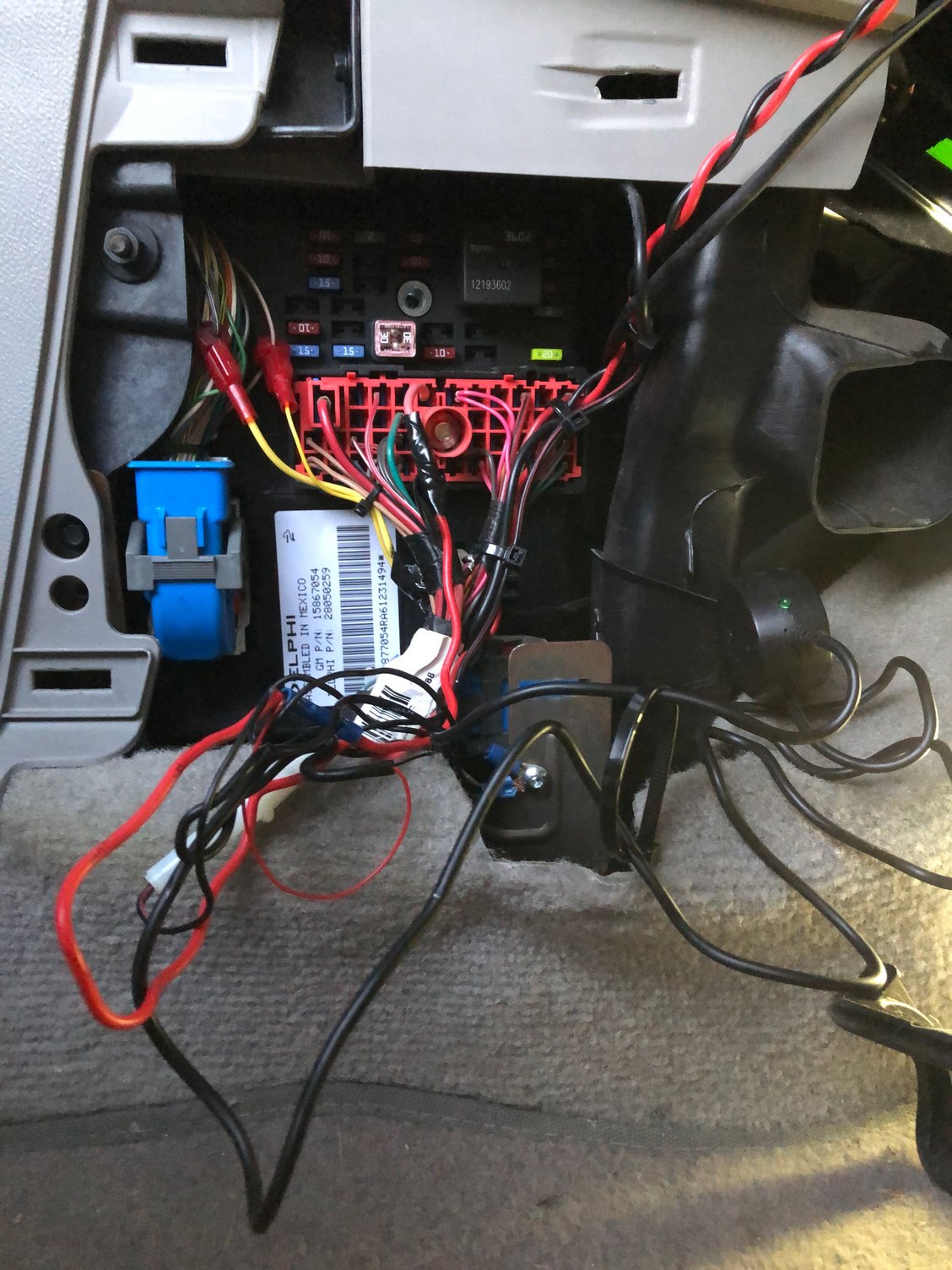

im looking for a replacement fuse box but it has to be from a 2006 only and am waiting to hear from a wrecker Monday to see if they can find one thinking maybe I can get a used one shipped to me?
when I went to the side fuse box on the passenger side found a bundle of extra wire spliced into a red power wire I’m thinking,the previous owner had plug ins for a phone maybe a Garmin maps,and something else,strated tracking them down and found two more spliced wires under the hood,
today I’m going to check the starter connections I did change it in -47* weather make sure everything is as it should be double check for cleanliness of connections,and hopefully pull the top half of the fuse box off and see if there’s noticeable damage.I’ll try and send a picture of the inside fuse box location .
it’s been a busy week so far 🤨

Was plugged into the #8 Ignition switch, pass key.
Extra wire’s spliced into unit.
Old Jan 28, 2024 | 11:19 AM
  #90
Posts: 40,097
Those extra wires could have been for an alarm or remote start from the aftermarket, or an aftermarket radio.
best to trace them down and eliminate them, reconnect the factory wires , tedious but doable
