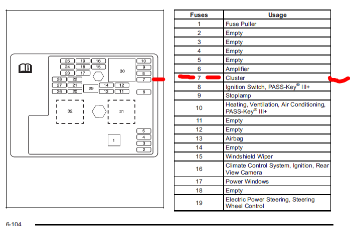

Old Oct 3, 2016 | 12:31 PM
aradmahogany's Avatar
Joined: 09-16-2013
Posts: 1,408
From: Tampa, Florida
Quick update to old problem, Since that night I haven't had the problem again all I did was pull and re seat the fuse on the passenger side for the gauges. In case someone a year from now was looking for a solution and didnt notice the solution in the first post LOL
