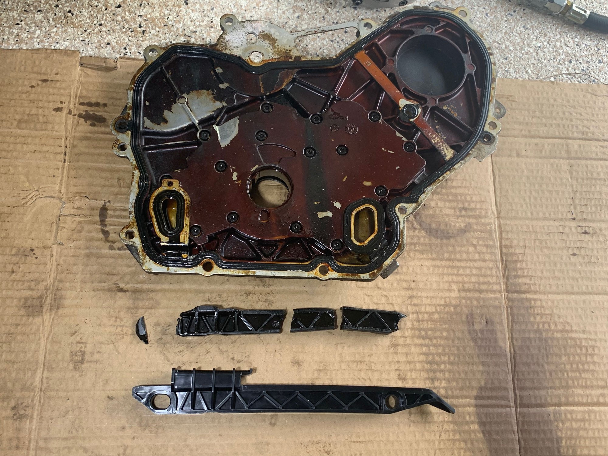

Pulled the timing cover off and the front guide fell out in pieces!
You can see where the chain was hitting the guide bolt head and also the inside of the timing cover.
I think the timing cover is OK, but I'm going to have to get some new guide bolts...
I haven't pulled the plug to look at the top front guide bolt yet.

There is a improved bolt and a improved guide. Oldblue will probably pop in shortly with links.

ZZP has this kit, I strongly recommend it if you’re keeping your HHR. Just the lower bolt and the upper replacement bolt

Now you know why you need the ZZP front guide. It comes with one guide bolt, I think, for the lower hole. The upper one should be the improved one.
https://zzperformance.com/products/z...ng-chain-guide
Try to find all the pieces. You need to remove the oil pan. Be sure to check the oil pickup screen. Ask me how I know.
