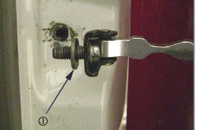

TSB 09-08-64-001A says to add a couple of washers to the check link mounting bolts.
checklinkTSB.pdf
