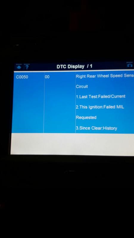

Yes the code has extra digits, sorry for missing that out. I have attached a pic of the screen of the reader.
Would you consider this is something I could track down? or should I rather take it to a specialist?

Old Jul 8, 2016 | 09:30 AM
Posts: 26,532
My suspicion would be to check the wiring going to the EBCM from the RR wheel. Wires get chafed or burned.
Did anybody mess with the EBCM connector jut before this problem? Then likely a bent/bad pin.
Could be the connector at the RR, or a pulled wire.
Unfortunately, that code only tells you something is wrong in the circuit, not necessarily any component.
Start with disconnect/reconnect connectors, then continuity check wires and check for shorts. If you know how to do that kind of thing you don't need to pay someone who does.
Cheapest to most expensive:
connectors
wires
hub
EBCM
