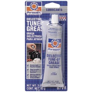

Dielectric uually comes in a tube (like toothpaste Geg). A good way to apply it is to put a small amount onto the contacts. Once you reconnect the plug, the dielectric grease will spread and protect the contacts from future or further corrosion. I hope that explanation is useful for you.

thanks for the info.
Last evening tried to buy the dielectric grease.
In shops it is almost there. And where is - a very expensive (420 rub. = $ 15 for a small tube). Apparently, the shop-soiled goods. Small demand.
Trying to use. If I would have questions about these connectors, I'll ask them.

What do you think? I was not able to buy a goddamn dielectric grease! All over the goddamn Ekaterinburg no goddamn store with dielectric grease! Some sellers do not even know what it is.

No. That is the opposite of the grease. You could use the spray on ignition wires and distributor caps to get the moisture out of older cars electrical systems. The spray would only destroy the ECM contacts.
Try an electronics store (like our radio shack) or go to an electrical supply house or store and explain to them what you need to protect from corrosion. Maybe they have an equivalent for electronics.
Also try a motorcycle repair shop.
