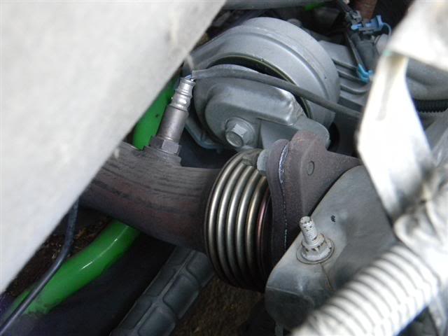

Originally Posted by 843de
Another possibility once the airbox is checked for proper installation is a cracked down pipe leading from the exhaust manifold, if they break you will get a commotion close to what you's hear from a loose airbox.

Originally Posted by nacademus
A cracked downpipe/flexpipe would sound like a hiss and tick. Does it tick? You should also get a code.
no ticks and no codes
Flex pipe............ and you may or may not get a code, but you will get the noise.
I suppose a muffler shop might be able to tell me? I haven't been to one yet.
Old Aug 31, 2011 | 04:22 PM
You can see the flex pipe from the engine compartment, if it's cracked you will see black on it. (normally it's rust colored) You will also hear it really well if the engine is running and someone blips the throttle while you are looking at it....... Just don't get burned.

I checked the airbox (and changed the filter while I was at it) to make sure that it was secure. My neighbor came over to give it a listen (he's a certified mechanic) and his words were, " Wow that's going to be a tough one!" lol. He sat in an out of my vehicle while I was making the sound happen and he was stumped. I have to drive to Little Rock for a flight next week and if this is an exhaust leak I hope for it to at least be more noticeable after that.
Here is a pic of the flex pipe. It looks ok to me.

It does look fine from the pic.....
