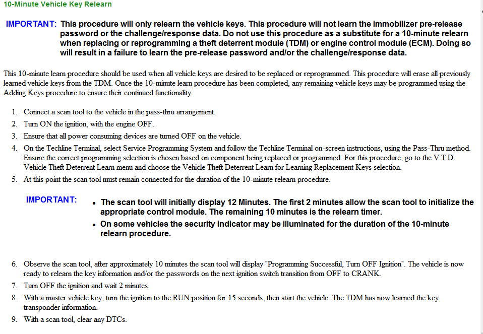

Originally Posted by donbrew
I was just looking at the "book". There are 2 different key relearn procedures; 10 minute and 30 minute. If you replace the ECM you MUST use the 10 minute method. That is the one that requires a Tech2 or equivalent.
I did put a new, programed to my car, ECM in my 2011 without having to do any security fiddling. It was just plug and play, aside from having to re learn the crankshaft sensor. But, that was for the correct engine, year and BCM.
Attachment 21717
so I am going to buy a tech two scanner any thoughts on a clone vs a $4000.00 tool
It would be cheaper to put the right engine in than spend $4000 on a tool, hoping it will fix everything. Then resell the engine you have now. Probably even cheaper than a clone.
