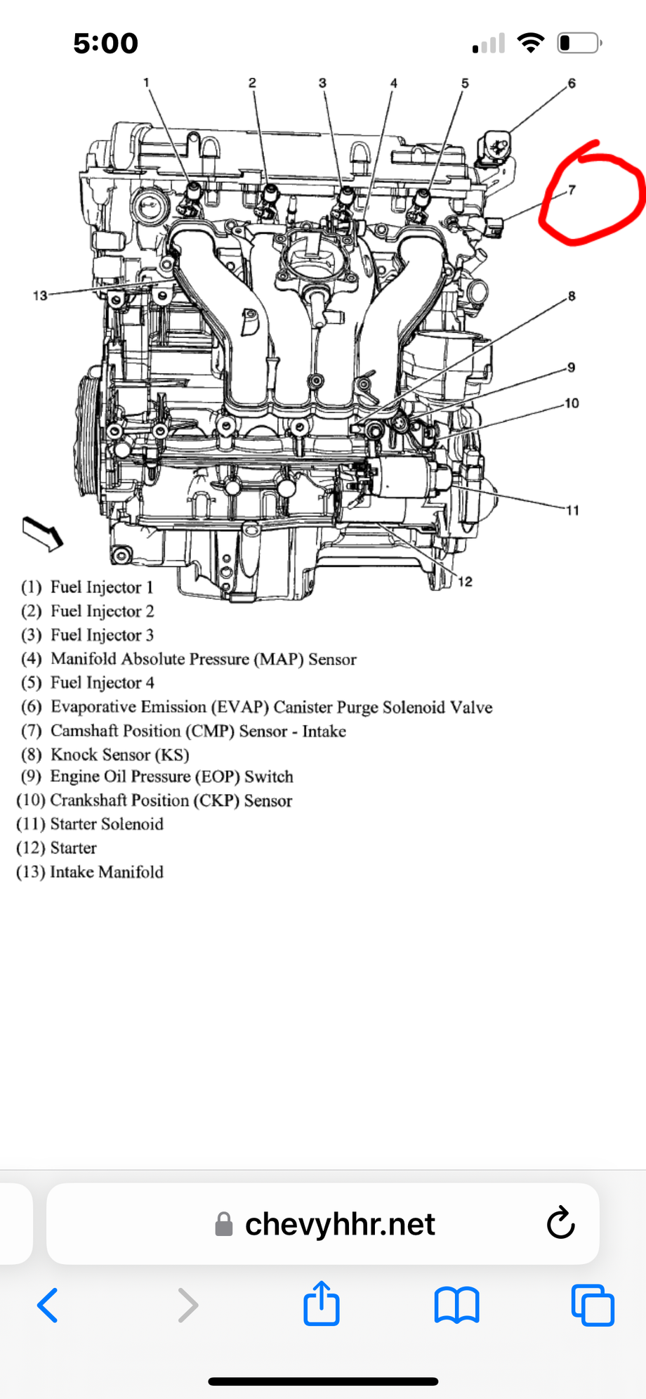

The 2006 2.2 might have camshaft sensors, they are at the drivers end of the cylinder head, look to ensure they are there , before you Oder them
That’s the intake sensor #7 look on the exhaust side for that sensor

Thank you for responding with the diagram. I did see this on another thread but others said it was behind the timing chain cover or it didn't have one. I watched a you tube video where it was located right on top of the motor. Unfortunately, I haven't been able to locate it. I did change the ICM and the air filter and oil and oil filter. Was hoping I wouldn't have to get under there....I've my 06 for ten years and this is the first problem I've had. Has 159000 miles. It's been a great car. Thanks again, have a great day!

Posts: 40,083
They are pretty easy to find and just 1 bolt holds them into position. They don’t fail often, so inspect the harness

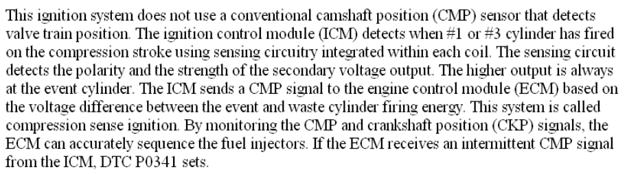

Posts: 26,532
2006 2.2L does not have camshaft sensors.
from the service manual:
