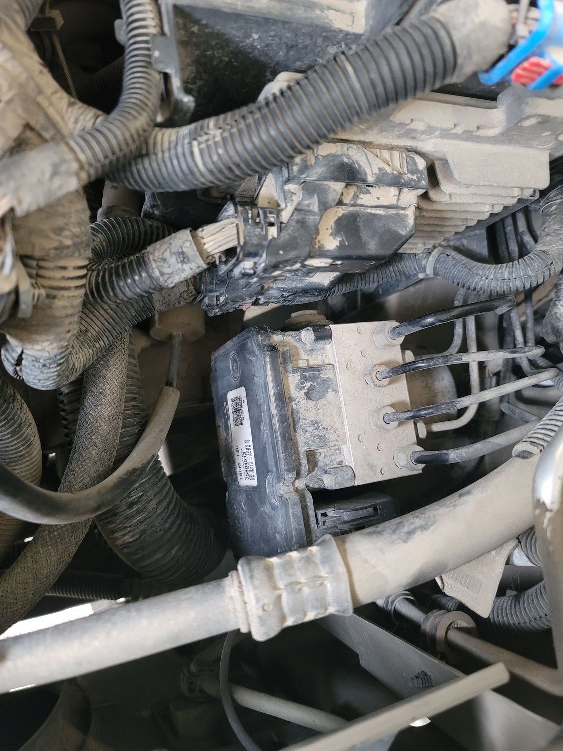

The EBCM has a problem. Maybe, wires, connectors, fuse or the unit is destroyed.
It would be helpful to know what codes made you do all of that stuff. The descriptions that they give you are usually misleading, the numbers tell the truth.
You might check fuse #44 under hood fuse box.

Yes I just checked it is a 2.4 , And yea I think the mechanic just doesnt want to deal with it since he mostly works on my Inlaws Large trucks, I don't see any torn wires or anything, I went through the whole manual and It only states to go have it serviced at the dealer ship, then those warning lights come up. I will keep trying to find a solution and get back soon.
