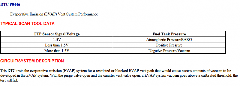

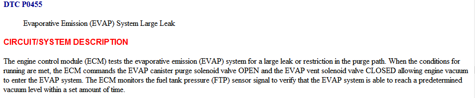

BTW, P0446 is a performance code, P0455 is "large EVAP leak".
