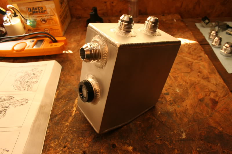

So you wouldn't be interested in this style can either?

Originally Posted by 1Panel2NV
Just twist it back and forth and it will come out. You'll have to reuse it once you get whatever other hose you're going to use on there. I'm not sure how good the seal will be if you do that though.
Me likey!

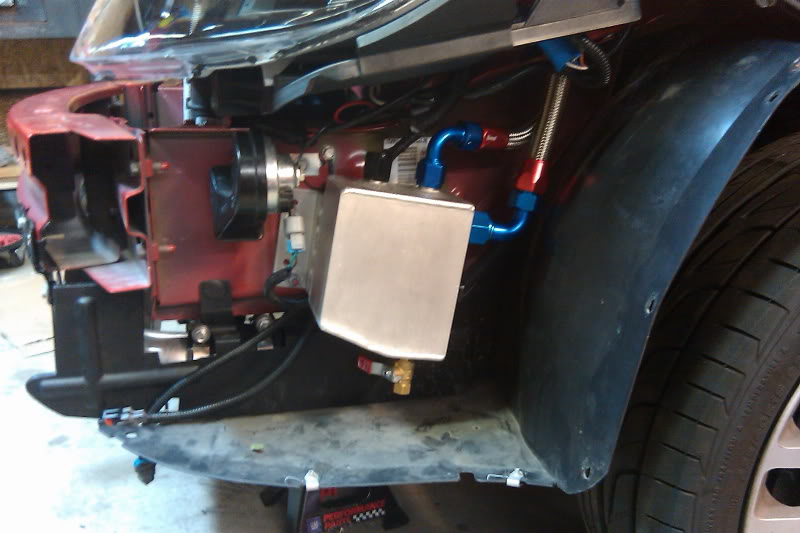

Here is the finished install. Routing may vary with an HHR.
