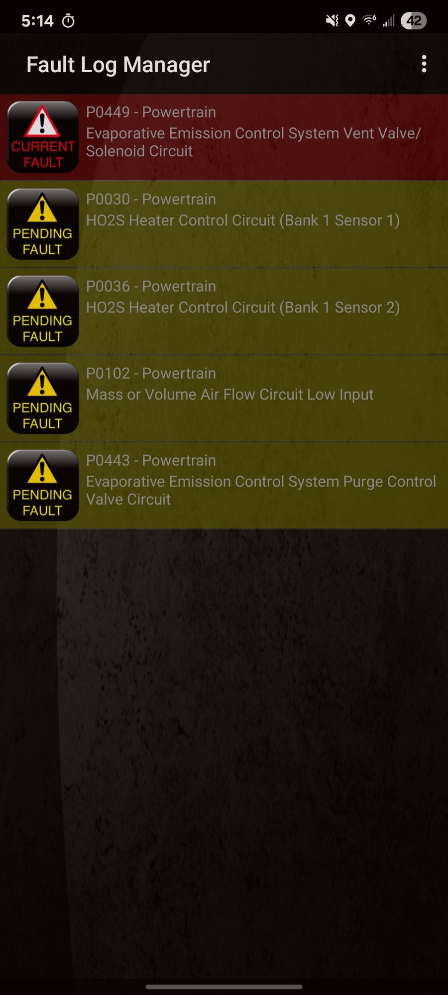

I have a 2008. Brief: broken muffler mount point (looks rusted), looking for action steps with that and if it's salvageable. Also a broken wire on driver's side of muffler, need help with that. Lastly, error codes (p0449 + others).

I'll try to get pictures to help more. Like I said, cold and snowy, and don't have a lift or an indoor garage to help. Posting the error page from the OBD2 in case that helps kickstart something.

Muffler hanger bracket is available on Amazon, I used an 1 1/2 clamp hanger
the codes are related to the broken wire, if it’s from the chassis harness to the O2 sensor, replace the sensor.
the battery may have charged but it’s not holding a charge, you should see 12.5 volts or more , if not time for a new battery
that P0102 code tells me you didn’t reconnect the MAF sensor

Thanks for the thoughts, everyone! Update: the wire turned out to be the little red light on the bumper. Apparently that's been missing. Not sure for how long, but there is no bulb there anymore, nor a socket for it. Just wires.
