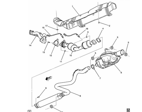

Sounds like you want to use a 2010 exhaust; 2 cats and a resonator.

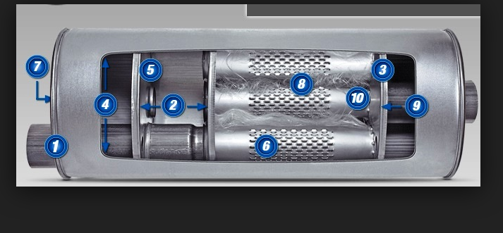

This is a Walker Quiet Flow; it looks way more restrictive to me.
