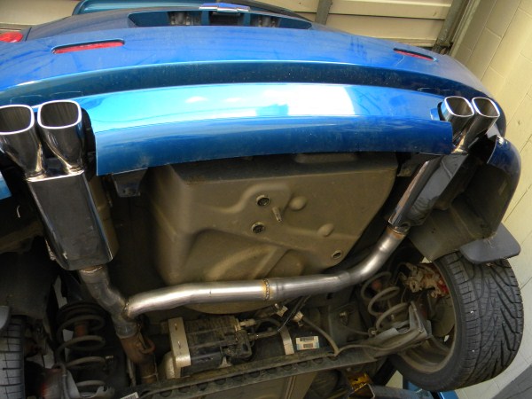

This V-8 has mufflers first , then the resonators
This is similar to our Sunfire GT exhaust, but the mufflers have dual outlets, very nice!
Another member asked Y we answered why not!
