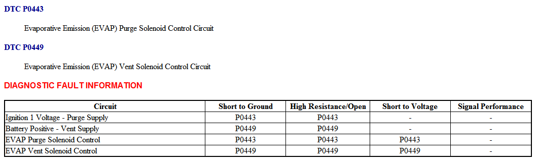

Here is the VOM testing data for both valves:
