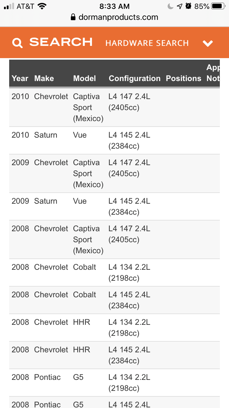

Doing exhaust manifold today. Thought I’d have a stud set on hand just in case. But I can’t seem to find one. I’ve not yet called the dealer. I can’t even find a part number on gm parts direct.
I’ve called Dorman and asked about their set which works on the list below. But service tech said it’s not the same on the 09 2.4l HHR?
Anyone got some wisdom for me on this?

thanks Dave. I can get a set from a dealer 50 miles out. But after a long search I confirmed the dormann03422 set will work on my le9 and I can get them here. Is Dorman going to work? Or will I have to drive the distance with this cracked manifold?
how difficult is it to get the old studs out?
