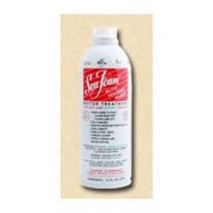

As for the fuel injector cleaner, I know what you meant, but a bunch of people kept telling me to try that to see if it fixed the idling.
With the SeaFoam, I just follow the instructions on the website? Where would I then check for leaks?
Once you run it for few miles and then change it, along with a exterior cleaning of the motor. If you have an external leak, the wet oil spots will be the tell-tell sign.
I'd run about a half can in the block. You can dump the rest in the gas tank.

No need to dump any in the vacuum line?
Not at this time, that's for cleaning the combustion chambers, etc....
As Solman suggested, just in the crankcase thru the oil filler tube. To clean the oil galleys & passages, etc. Then as directed do a proper oil & filter change.
