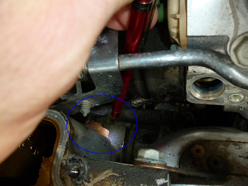

I took the valve cover off today to inspect. See the attached short video of the chain slack. What do you think? I assume it should not have any slack whatsoever, correct?
I also peeked at the tensioner. Mine has the bump in the top. Pictures are attached. Is this the new style tensioner?
I peeked closely at the cam sprockets, chain, and the upper guide. They all looked to be in reasonable shape. I didn't see any excessive wear or broken/chipped pieces. Is it possible the tensioner may just need replaced? That is, is it possible it just froze and is no longer providing the needed tension? Or is replacing the tensioner without the chain and guides a bad idea?

Old Jul 1, 2017 | 02:29 PM
  #39
Posts: 26,533
Should be no visual slack, That is a lot! That is the new tensioner, as far as I can tell all VVT engines have them. They are hydraulic, the get to a point where they can't reach far enough.
A new tensioner comes with many kits.
After seeing the chain, I think we are past the "talking yourself out of it" stage.
