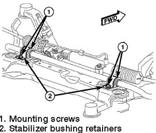

Sad to hear of your health issues, but happy to see you are recovering, I have changed these bushings before, and it’s just that bolt through the sub frame that needs to be from underneath.
The 15 mm bolt heads can be reached from up top with 3/8 or 1/2 inch drive socket, a swivel and extensions to the ratchet, then the bushing is accessible from the side , remove the tires and they are behind the steering rack

True that the bolt for the LCA bushings are the same bolts that hold the cradle, but you do one side at a time. That leaves the other 3 bolts. Really easy work, sounds like they don't want the business.
The hard to get to sway bar bushing bolts can be made easier by partially dropping the cradle; loosen those same bolts and lower the back of the cradle a bit with a support under it if paranoid.

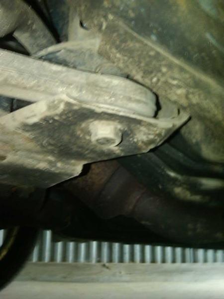

Posts: 40,087
Engine cradle bolt / rear LCA bolt 21mm
Old Oct 11, 2019 | 10:41 AM
Posts: 40,087
Bolts from the top 15mm
