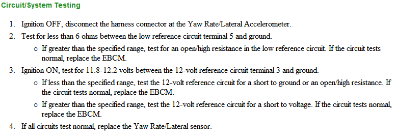

First check your Yaw sensor since that is the sensor in question (C0292). Has the car ever deployed airbags?

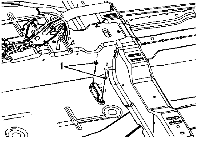

Vehicle has never been in an accident or had the airbags deployed. Looks like the sensor is under the center console. I believe the Autel scanner I was using can check the sensor in Live mode. I will have to check it out this weekend. But, at least I have some direction to go in. Does the EBCM module have to be programmed if replaced? Also, when these warnings came up, the transmission was hard shifting. From what I have read, this code causes the 12 volt reference to drop out until vehicle is restarted.
Old Jul 25, 2019 | 10:12 PM
  #44
Posts: 26,532
The EBCM provides the 12V ref.
The #1s in the drawing are the nuts that hold it down to the floor.
I think the EBCM does need to be programmed.
