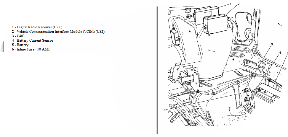

Do you have an antenna mounted in the quarter panel window and a 2-way remote? That's the only reason your RCDLR would be back there where the service manual says it is. It is really under the headliner bump next to the mirror.
VCIM is the OnStar.
