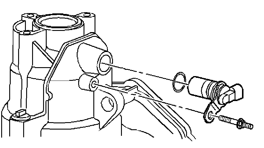

Thanks everyone for the info and suggestions. Hoping to get the battery tested this weekend, check the fuses and if need be get under the car to check the vss. I'll post whatever I find and hopefully the solution (if I have one). Thanks again!
