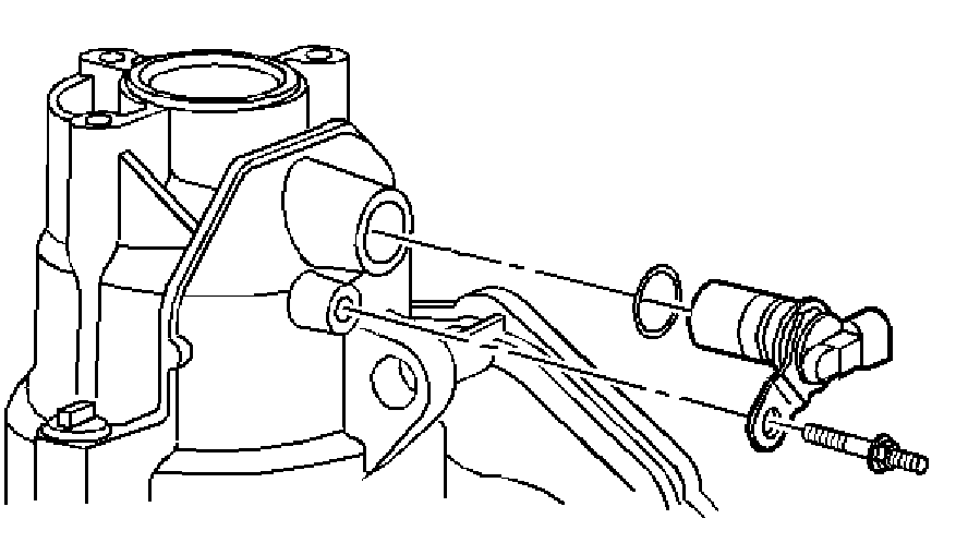

Originally Posted by donbrew
There is indeed a wire connection to the transmission that could have been compromised by that snow bank. It is the Vehicle Speed Sensor!
Attachment 20895
This speed sensor will give a "power steering" message if disconnected too... One of the first rodent chewed wires I've had since moving to the country. I didn't have hard shifting or speedo problems though, just the power steering message. (no power steering problems, just the message)

A wheel speed sensor wire might do it too.
It may depend on how the wire is damaged; I would expect a lot of weird things if the 2 wires are sorting vs just broken or shorting to ground. Electrical gremlins are very clever!
