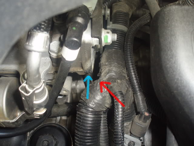

I was changing the oil today and noticed this:
The red arrow on the harness was rubbing on the blue arrow of the engine.
I don't think any wires were affected by the rubbing, but it does look kinda bad.
I re-routed one of the connectors and it pulled it away from the engine.
Thought I would let everyone know of this problem on mine you might check yours.

I remember a thread about this posted a long time back and just found it.
https://www.chevyhhr.net/forums/show...=wire+chaffing
read post #10 and click on the image, you will see it is the same. This may be good that tooter1 brought this to our attention again.
