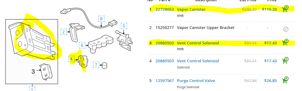

Replace the charcoal canister and vent solenoid. That black box behind the gas tank. MSRP for the part is about $200 plus about 45 minutes labor. If you can figure out how to uncouple a few rubber hoses you can do it in less than one beer.

There is, however a vapor pressure switch that activates the canister vent. Can't pour gas in without letting air out.
There is also, the fill limit valve.
So either the pump or the canister could be bad. Either or both far less than $2500 and driveway do able.
1. air into charcoal
2. tank vent
4. check valve
2. tank vent
4. check valve

Is there a complete picture of this vapor system?
I know it's been said, never try to top off when you fill up because it can go into the charcoal canister. That would be thru the vent line (#2).
