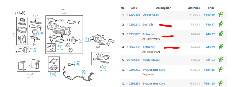

Could be the actuator(s) or there have been some that found the seals failed and are flopping around.
Temp actuator,

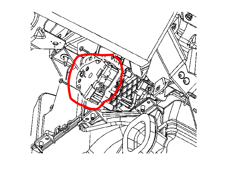

So what's happening is the temperature actuator motor is getting stuck half way. I poked my head under the dash when it failed and it turns to the middle, half hot half cold (lukewarm) then all of a sudden it moves and goes to hot. I think that's where my problem lies ��
Old Feb 19, 2017 | 01:09 PM
  #45
Posts: 40,083
Me too, that's the way to get to the problem, get in there and have a look. The bolts that hold the actuator are 4.5 mm

I just pulled it off again and ran it with it hanging. It sat there and moved back and forth from hot to warm on its own on the actuator. That tells me the heater box is ok. Now it's just a matter if it's the actuator itself or the control assembly on the dash. I think the actuator is easier and cheaper lol
Old Feb 19, 2017 | 01:42 PM
  #49
Posts: 26,533
I changed the part # in the parts thread. I believe Dorman also makes a replacement part, so you might be able to get it from NAPA/Advance/Zone etc.
