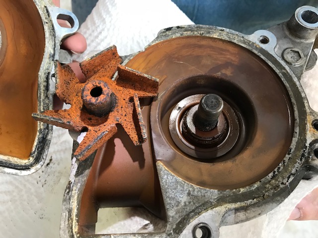

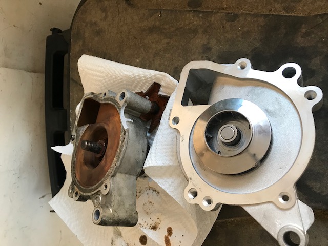

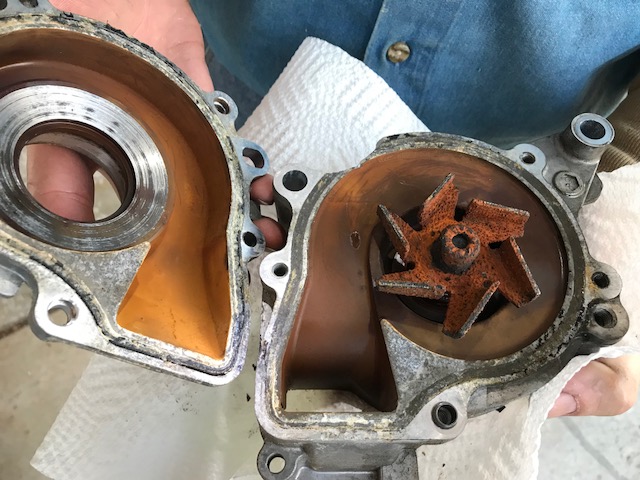

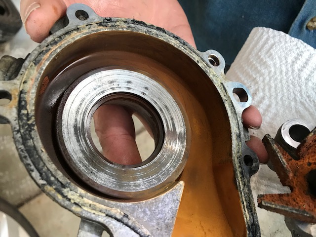

Another page in the water pump/fluid loss/thermostat issue. BTW, my brother is doing the work, I'm in charge of research and purchasing. The outside temp is above freezing (been 20-25 degrees below normal here), so it's semi-bearable to be out working on the car. I'd like your opinions on the water pump, pictures included. In one of the YouTube videos I watched, the tech said that replacement should be a no-charge at a dealer; but the local Chevy dealer (who did the ignition recall items) said, no, "not with that VIN #". So, it's a known problem, a re-call item? The old impeller was totally disconnected from the shaft and wore grooves in the metal plate. Looking at the new pump, the impeller has a protective plate on it and in my opinion, makes the old pump look like a thin, cheap piece of equipment (biting my tongue here). In your opinions, is the old pump with its flimsy impeller SOP and not a recall item? Yes, it's a moot point, since the pump is off but might filling a complaint make a difference for other people with the same water pump? Your opinions/suggestions are appreciated!!

I'm going to say that is an updated vain pump and it looks like a bigger shaft also. The stains/rust on the old one points to a cooling system that was not maintained. I would consider doing a flush to try to get that rust out of the rest of the cooling system. Your radiator/heater core is coated with it.
Yeah the rust stains alone tell of a sad life and lack of maintenance. Warranty? recall? nope, not a chance even without the rust.
As Cat Man HHR says, your radiator and heater core are coated - and hopefully aren't damaged too bad. I don't know if I would recommend a flush prior to refilling or not - it might be the kiss of death to the rad or heater... maybe?

Pretty clear that someone thought DexCool was dangerous. And liked to use flush agent that are not recommended for aluminum.
BTW that is a after market water pump, your new one is closer to OE.
I don't know where rust comes from in an all aluminum system. Maybe the heater core is ferrous, I don't know.

Don, that impeller looks like it’s not aluminum!
A 2009, would be 9 years old now and I’m seeing signs of neglect, in that corrosion in the system, that indicates, at one point, someone put

I do believe the water pump failed, was replaced with inferior part.
So, bolt up the new coolant pump, install a new AC Delco thermostat PN 131-158.
Pour in 50/50 mixed Dexcool, I don’t recommend mixing it yourself, but the premixed.
Make sure you burp the system , change the Dexcool, every 5 years!

The more I look at it, that might not be rust it could be the residue from overheated DexCool or the red stuff. Only a chemist could tell for sure.
But the OE pumps have the enclosed impeller, like the shiny new one has.
