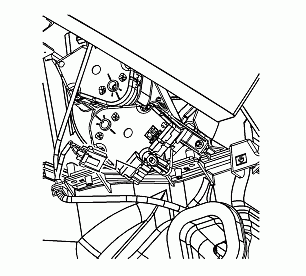

Actuator Replacement
Temperature Valve Actuator Replacement Removal Procedure
  1. Remove the fuse labeled HVAC CTRL (BATT).
  2. Remove the knee bolster reinforcement.
  3. Disconnect the air temperature actuator electrical connector.
  4. Remove the air temperature actuator screws.
  5. Remove the air temperature actuator.
Installation Procedure
Important: The key should be in the OFF position when connecting the electrical connectors to ensure proper calibration.
  1. Install the air temperature actuator.
  2. Install the air temperature actuator screws.
  3. Tighten the screws to 2.2 N·m (19 lb in).
  4. Install the air temperature actuator electrical connector.
  5. Install the knee bolster reinforcement.
  6. Install the fuse labeled HVAC CTRL (BATT).
    Important: Do not adjust any controls on the HVAC control assembly while the HVAC control assembly and actuators are calibrating. If interrupted improper HVAC performance will result.

I haven't seen this on an HHR yet but on GM big SUVs and Trail Blazers when you disconnect the battery they actually lose their calibration and quit working or the actuator flips over and won't work. These are usually high mileage vehicles and mostly this occurs on the mode door actuator not the temp door actuator.
The only other thing it might be besides the actuator, is the HVAC control head. You would need to know if the signal was being sent from the head to the actuator to know for sure which one it is.

It was a while back and a friend of mine fixed it. He said it was the control rod actually broke and he had to glue it back together and put a sleeve over it. Has worked great since. I noticed one thing when you have the air on high it is seems harder to move the knob so that may have had something to do with it breaking. Now I turn the fan off or on low before I move the control knob. Have not broke it again.....
Thanks ChevyMgr the drawings and information helped.
