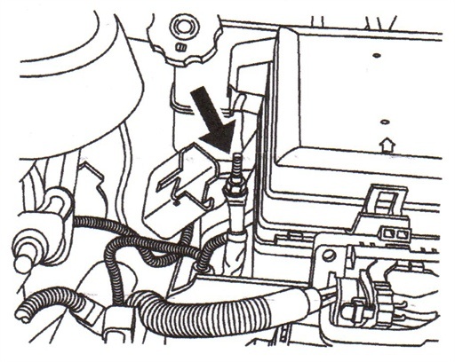

Welcome to the site The best place to start is to get the trouble codes read and check the trans fluid level.
Just for fun check the battery connection at the under hood fuse box and make sure it's tight.

Thanks for the quick reply. I disconnected the battery in the trunk and reset the computer, No difference. The connection under the hood is good and tight. I have a new Transmission Output Sensor coming in tonight. I am going to try that since she said that she was messing with the Cruise control when it starting acting funny. Advanced Auto Parts says online that this sensor has something to do with the power steering, Cruise control, Speedometer and I found a guy on youtube that was changing a Vehicle Speed Sensor on a mid 90's GM and stated that the sensor caused his transmission to shift funny. Sound like a good place to start. But input from you guys is welcomed.
Old Apr 17, 2014 | 04:58 PM
Posts: 26,564
Sounds like you like to take advice from "some guy" and throw parts at things. If that works for you, I am happy.
More likely, you have a problem with the under hood fuse box.
