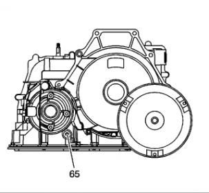

Yes you can add fluid to the trans. there is a post on here somewhere on how to do it. you add through the vent tube and there is a plug you take out and when it is full fluid will drip out . reinstall the plug/bolt and your good... Yes the slipping seems like low on fluid!
