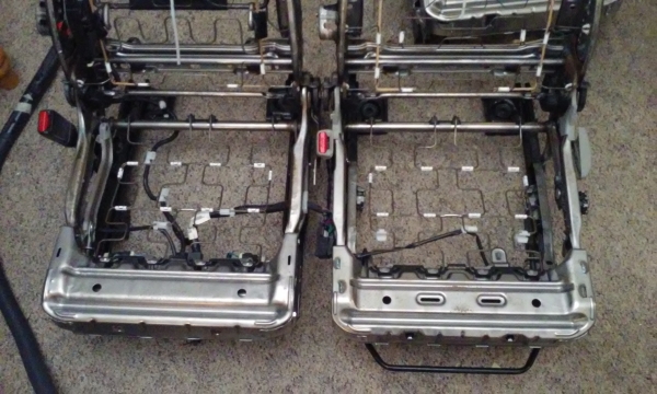

much to my dismay the SS has a seat frame that encompasses the entire seat, as opposed to other models that have a separate frame for the bottom and the seat back. The cost of only the frame was $816.99!!! :
I'll bet that the difference in the frame is only the shape of the pan at the front that drops the center of the pad down, and that all the adjustment components inside are the same. These are the power and manual frames for the non-SS, I knew I should have taken more pics.
