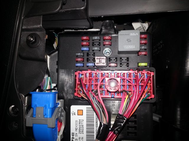

So. The green wire in the lower right corner is not it ?
Attachment 16332
No, I wish! Lol. that one is just a very small gauge wire

The green in the doors is the same gauge as the red wire with the black stripe that's above the green in your pic

Well, thanks for tryin!! :) the only wire on the whole BCM that I can find that's the same gauge as the green wire in the doors, and only has power when the key is on, is a big brown wire on the back of the BCM in a big white plug..... I tried taking the top off the dash to see if I could follow the wire but apparently u require a fire axe to get it off! Lol
