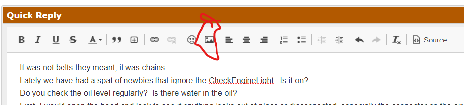

To post a pic click on the landscape icon and follow directions.

The button for inserting a picture is right next to the smiley face, here it is on the far right. Looks like a postcard. Or maybe it's a sun over mountains.
