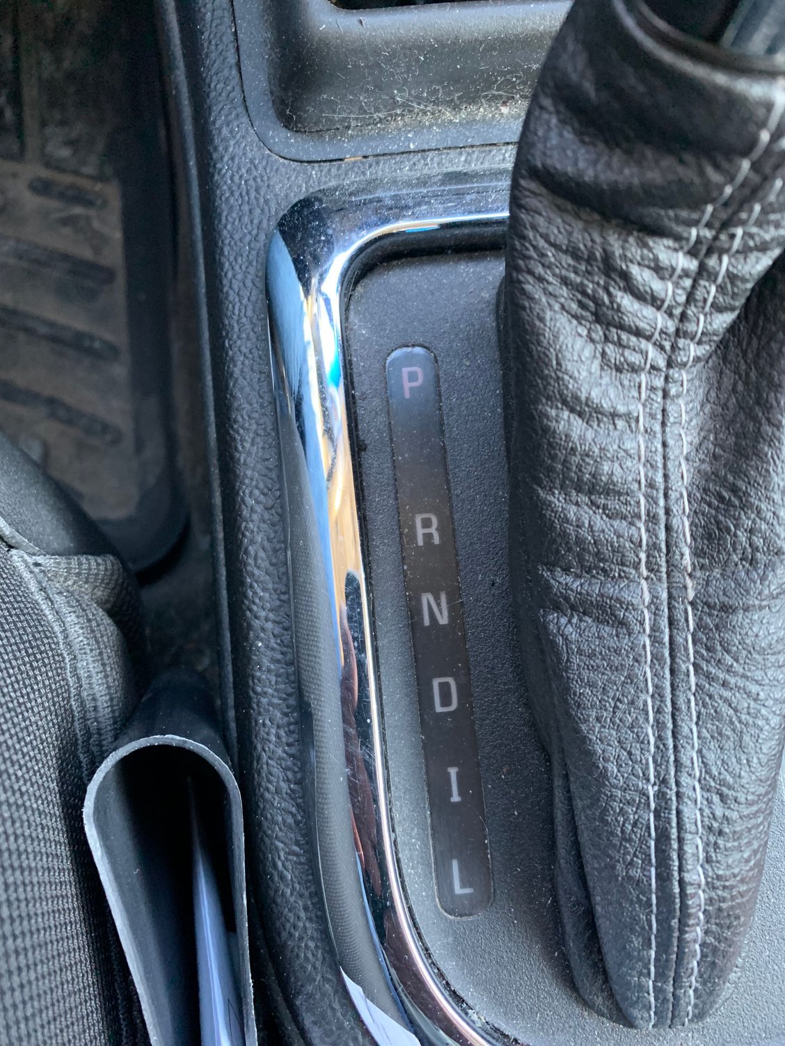

I’m just going on what my wife said, her car I just have to fix it. Says there was lights on the dash that showed PRND etc as to what gear she was in ??
Old Feb 7, 2023 | 08:15 PM
Posts: 11,719
No light on the dash for shifter position. It’ on the shifter console. Sounds like your wife is mixed up about which car she’s driving.

Well then I guess we both feel foolish now . I don’t drive it enough to even notice something like that.
sure glad I asked here before I started tearing things apart.

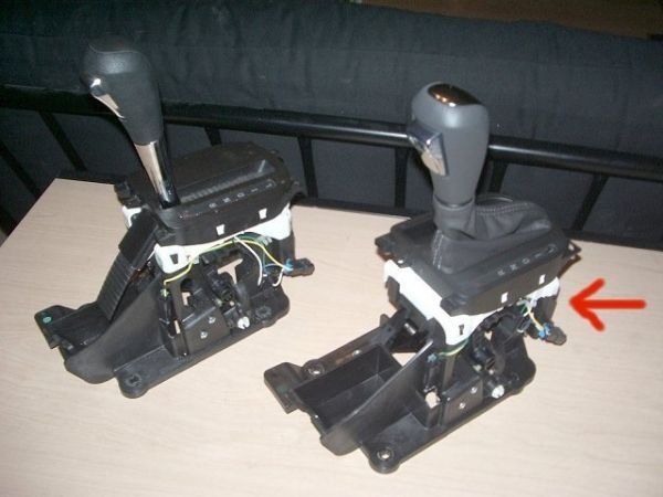

Shifter light lives down there , a #37 bulb you have to remove the console to get at. Not a bad job just tedious.
Old Feb 8, 2023 | 08:23 AM
Posts: 39,986
See the wires going up by the red arrow
