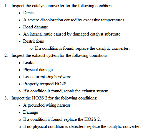

I never figured out mine. Everything I did temporarily fixed it. .73 is about what mine read, it really doesn't matter if it stays steady, the OBD test is a very fast change that you cannot detect.
This is what the book says about it:
