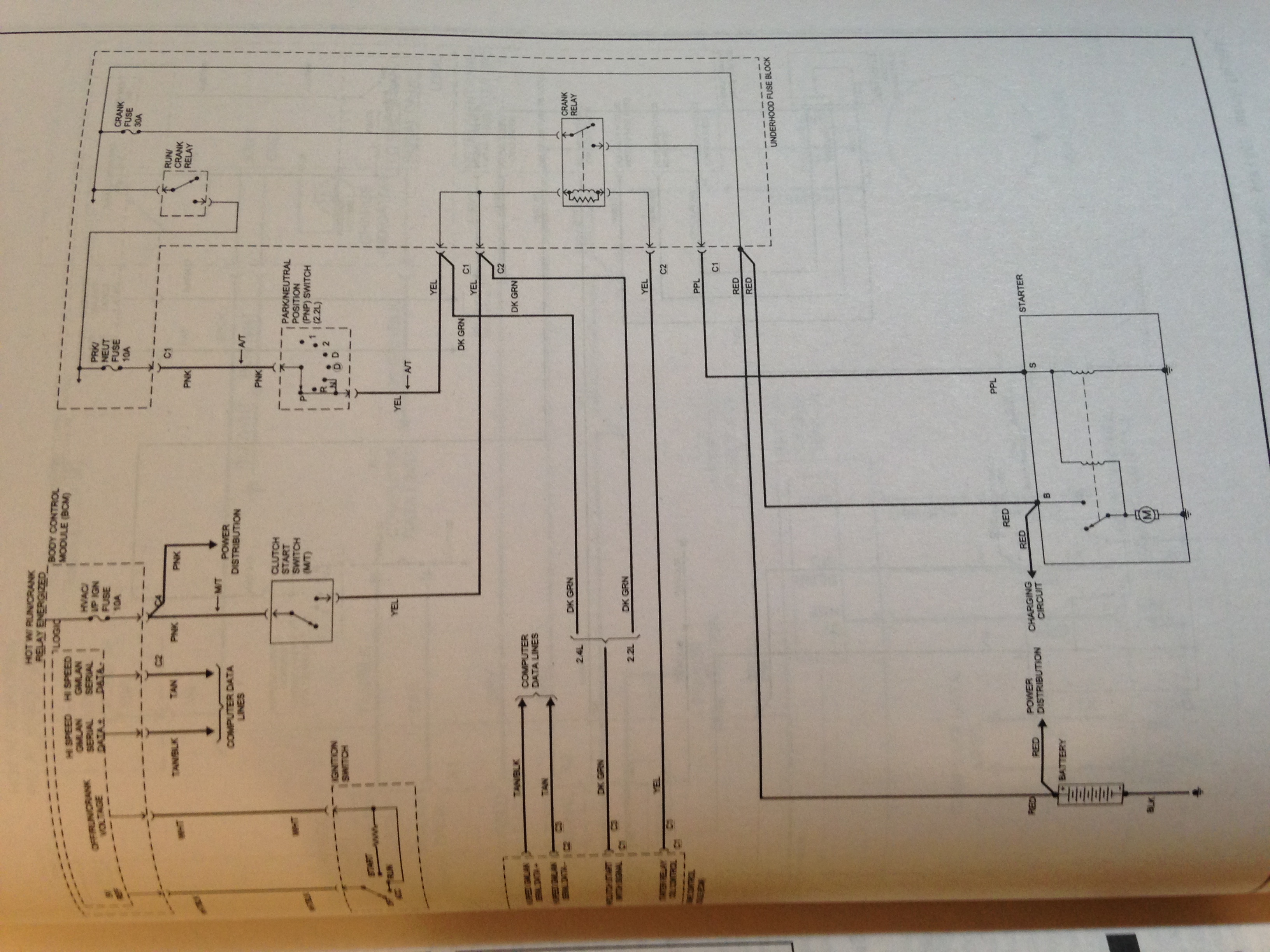

My wiring diagram for 2006 start system

Thanks but I think everyone here is missing the bigger picture it isn't just one thing if it was just the starter I could wire up a push button starter@$#/^ the fuel pump isn't working etc....
Anyone know a way to test the bcm? As I think everything that isn't working goes through the bcm?

Oh, I get the picture hence the schematic, the BCM and ECM control and trigger everything , a scan II tool will help pin point the issue!
Unfortunately your GM dealer or local auto electric shop will charge accordingly for the diagnosis.
The shorted out red wire fried the ECM and BCM most likely

That's what I've come up with after talking to him. The fuses and relays are not polarity sensitive and were isolated from the direct short. However, physically connecting the positive lead to ground sent +12v through all the chassis grounds. I'm guessing all modules are polarity sensitive and maybe the ECM/TCM would be okay if they weren't plugged in. But if the DIC still displays something and some gauges work your BCM still has some life. Maybe you shorted the column harness when you tried to turn the key..until then the harness was isolated possibly. I'd start by removing the wiring harnesses on the steering column and look for signs of damage there.
