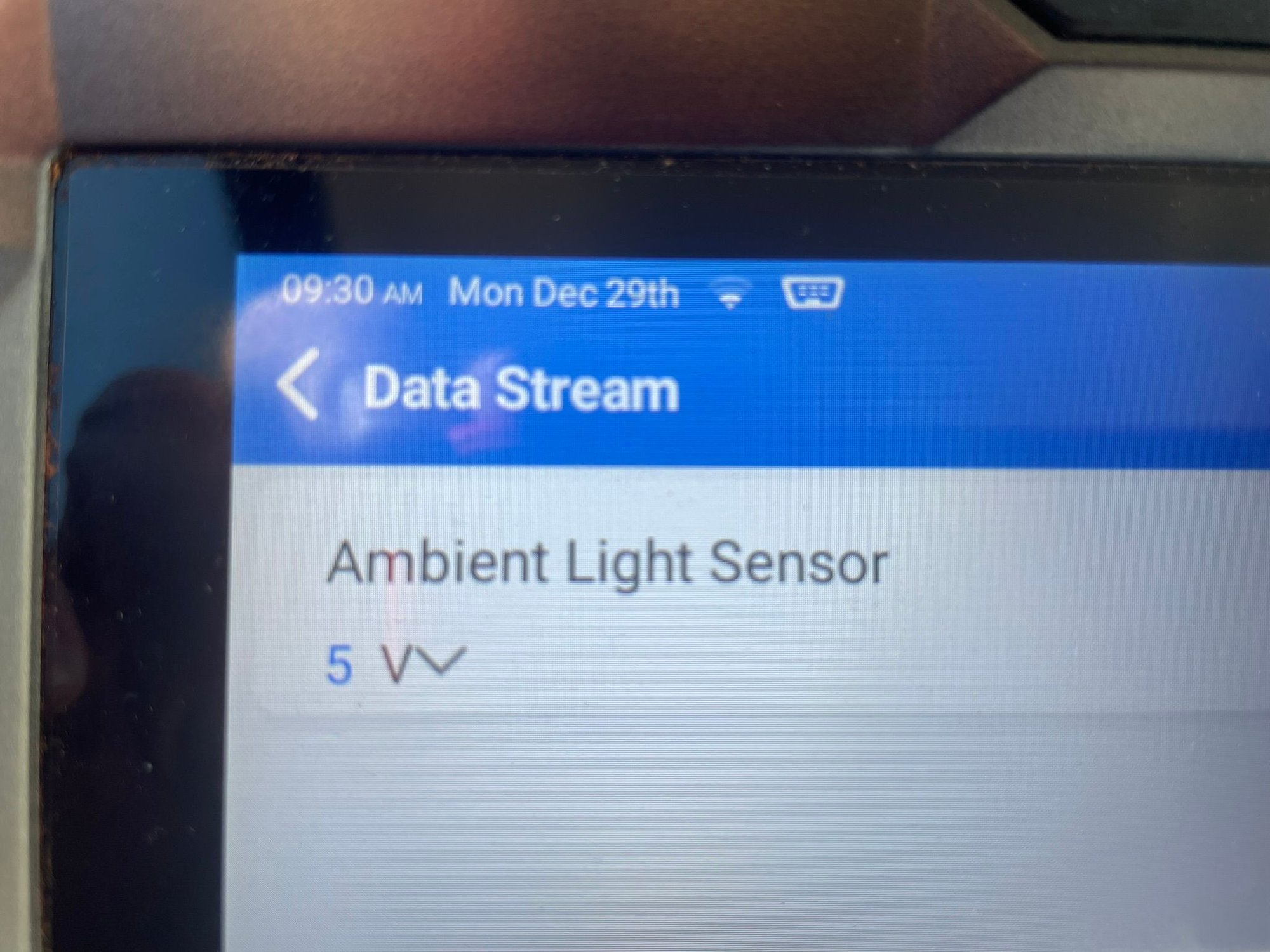

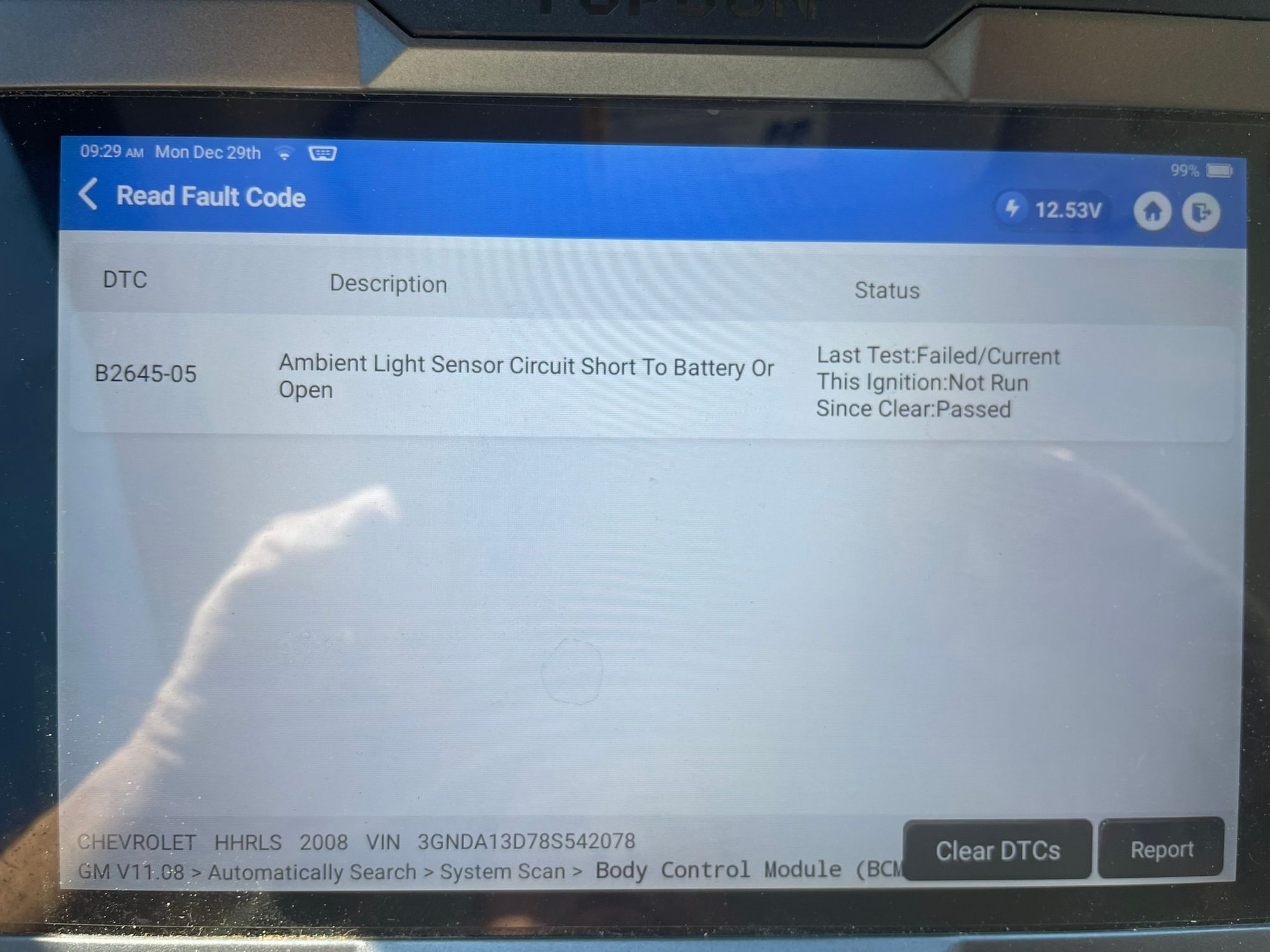

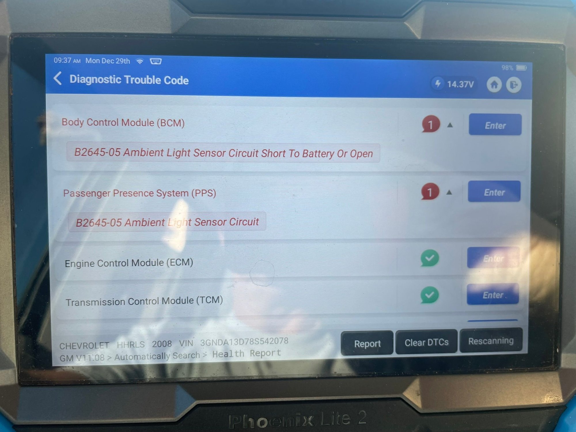

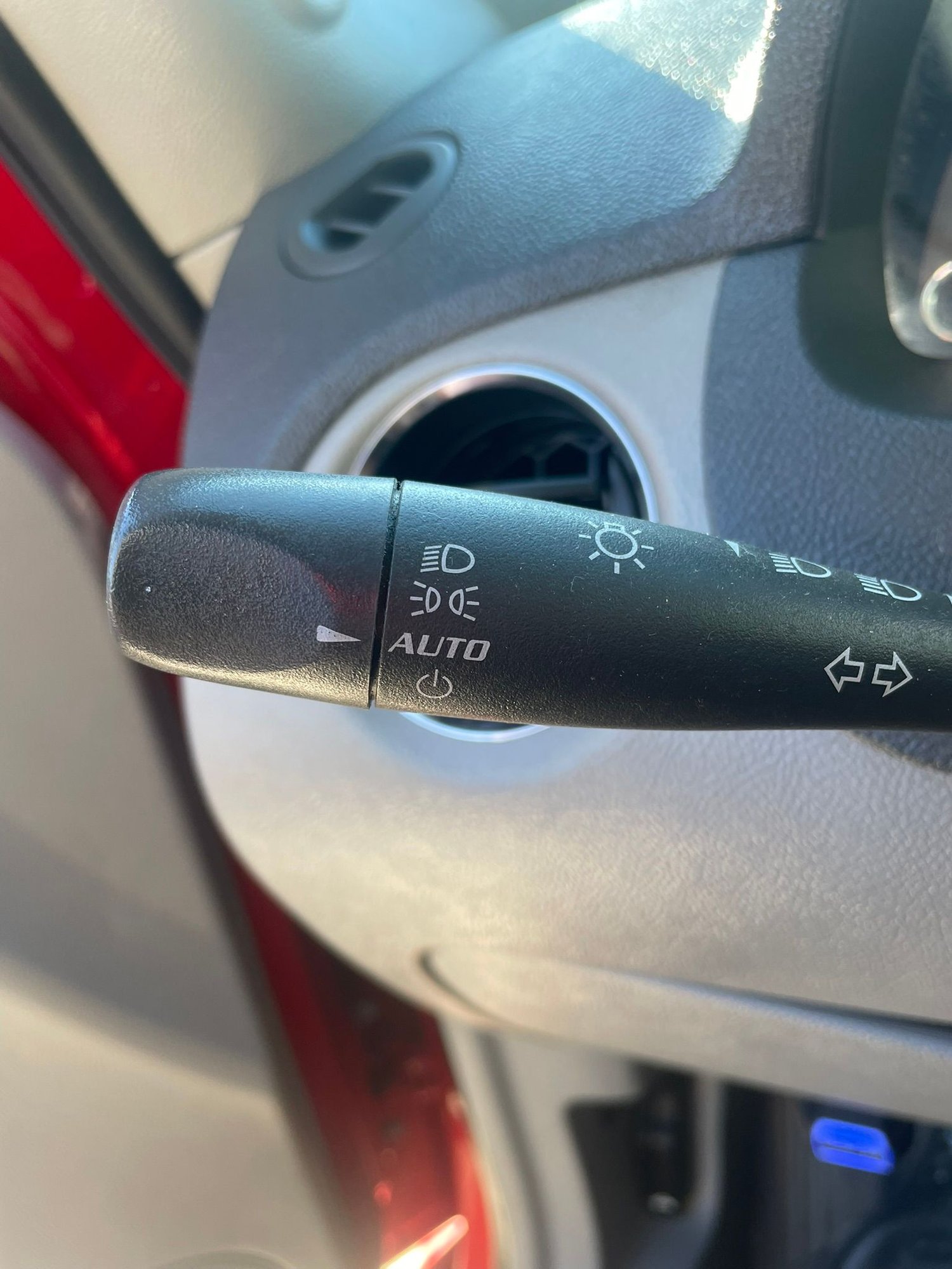

I ran a scan on the HHR this morning and here are the results pertaining to the ambient light sensor. It isn't the position of the light switch, I owned another HHR for 16 years and when the switch was in the AUTO position the dash lights would brighten and dim based on ambient light (day and night). If I switch to 'OFF' the dash lights are bright with this HHR.
When I issued the command to DECREASE the ambient light sensor voltage, the dash lights became bright (normal). INCREASE made them dim again. This proves an obviously defective sensor.
Opinions?
This is the default setting of the light switch. The dash lights should dim or brighten based on ambient light.
This is what the BCM sees from the the ambient light sensor in bright daylight with the engine running. The dash lights should be bright, but they are dim as if it were night.

This is what the scanner reads. Its not the position of the switch, the problem is the sensor.
This is what the scanner reads. It's not the position of the switch, the problem is the sensor.
This is the fault code, but it doesnt activate an MIL. This cannot be erased.
This is the fault code, but it doesn't activate an MIL. This cannot be erased.

What position was the stalk switch in when the scanner was used? When a switch is off it shows as an open circuit. When you turn the stalk to anything beside "auto" the sensor is off. The switch turns the sensor on or off.
Do the headlights/taillights turn on at darkness? If the tails and markers turn on the sensor is working.
