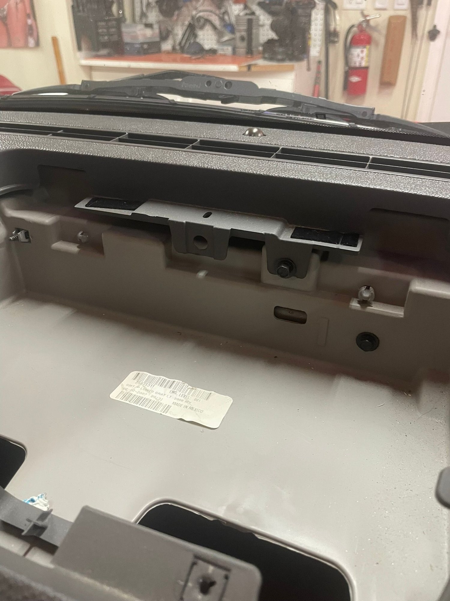

I finally took the dash apart as best I could, and found out that the light sensor wiring was never plugged in from the factory. It was coiled up just laying there, so I managed to get it connected and now the dash lights work as they should. I am making another rpost as to how I loosened up the top dash pad.

Must have been assembled on a Friday! Glad you got it figured out!
